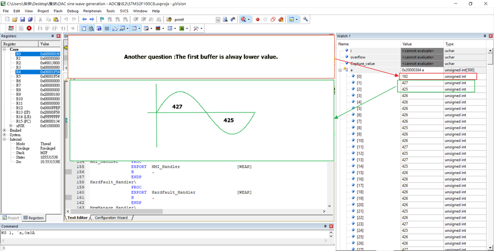

Experimentalphoto:
1: at intput 39kHz sinewave
count value=427+425 =852 >> 610
f=1/T=1/(852*0.042us)=27.9Khz it is wrong.

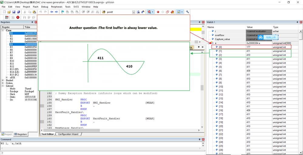

2:at intput 40KHz sinewave
count value =411+410=821>> 595
f=1/T=1/(821*0.042us)=29Khz it is wrong.

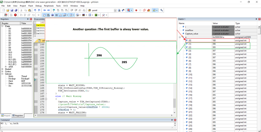

3:at intput 41K sinewave
​count value =396+395=791>> 580
f=1/T=1/(791*0.042us)=30.1Khz it is wrong.

Timer channels are digital with trigger voltage defined in datasheet.
If the input is not digital, jitter may occur in the triggering time.
One approach could be to prescale (average) the input in the timer (use channel 1 or 2 as they have more options around for this), so instead of measuring one period, you would measuer 8 periods for example.
I haven't used the internal analog comparator which maybe can convert analog to digital and feed the timer. Again, without hysteresis, there would be glitches if the signal is noisy...
waclawek.jan
Super User
Don't do this:
> TIM_SetCounter(TIM3,0);
rather, store the previous capture value and subtract the current from previous.
Agreed, use differential approach without disturbing the timer. This way, other channels can also be used when needed in the future.
