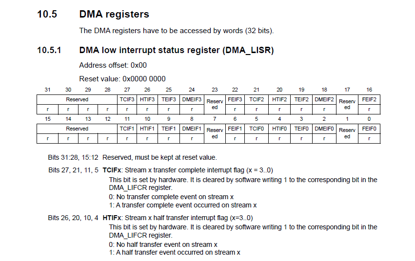

// From stm32f4XX_it.c
void DMA2_Stream0_IRQHandler(void)
/* USER CODE BEGIN DMA2_Stream0_IRQn 0 */
/* USER CODE END DMA2_Stream0_IRQn 0 */
HAL_DMA_IRQHandler(&hdma_spi1_rx);
/* USER CODE BEGIN DMA2_Stream0_IRQn 1 */
DMA2->LISR |= 1<< 26;
/* USER CODE END DMA2_Stream0_IRQn 1 */

Then , I set TCIF3(bit 27 ) to 1 after HAL_SPI_RxCpltCallback . But It worked only one time, the second dma receive did not perform. Did i miss any information about SPI_DMA? :\

IMO Cube/HAL clears the DMA flags for you.
