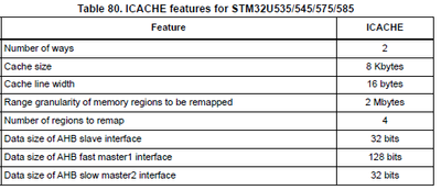

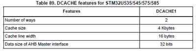

Depending on which STM32U5 you have the features of ICACHE and DCACHE might be different. Here are the features for STM32U575 devices.
Now to learn how to use them on the most efficient way for your application, please find attached the application notes AN5212 "Using STM32 cache to optimize performance and power efficiency".
