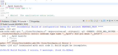

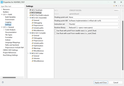

But still I cannot able to resolve this problem of using float16. I have same setting as you suggested. I have attached a screenshoot of the window.
 I tried to declare the variable like __fp16. but it does not work. I get the following error:
Did I missing something any library , compilar setting others?
Right, fp16 is no standard float format, the compiler "knows".
https://en.wikipedia.org/wiki/Half-precision_floating-point_format
So use standard float or calculate in fixed 16b int16_t .
Or use not the cheapest version of the oldest cpu, that STM produced.
