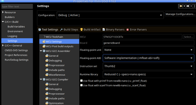

you can set it in IDE : menu -> project -> properties ...
set software ... -  to use floating lib here.
