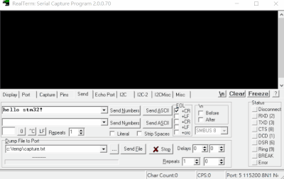

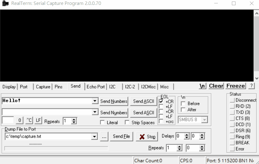

What is the correct flow to use HAL_UART_Receive_IT() to receive uart data?
The first package is lost first its first char,
Here is the flow used now,
From the gif, you can see "H" is missing for 1st package, and all normal for others.
The problem is that the we call "HAL_UART_Receive_IT(&huart3, &data, 1);" outside the endless while(1), which lost the first char "H"
Maybe it can solved by LL lib to solve it, I just want to know if it is possible to use all HAL function to implement a normal flow to receive data correctly,
Thanks,
