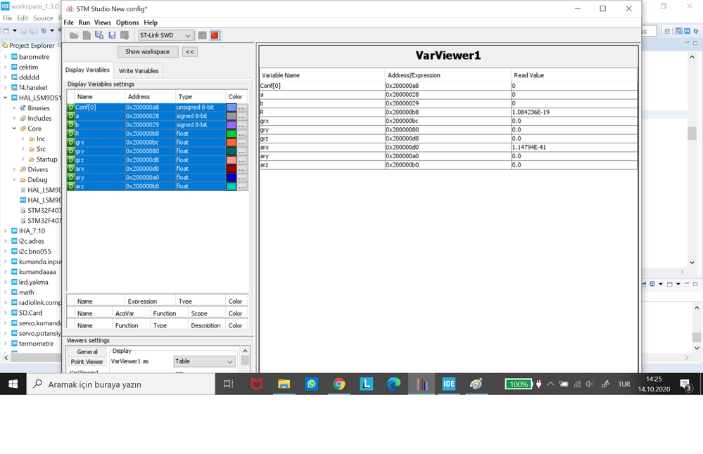

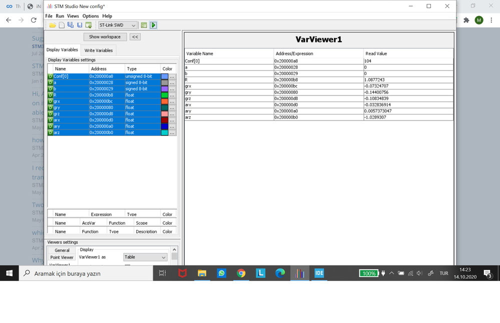

Hi everyone! I am using STM32F4 and IMU to read gyro and accelerometer, and than calculate IMU's euler angles. I can get data from IMU it is OK but when I try to add something from math.h program stops working but it also don't gives error or warninng -I can't even read acceleration and gyro data in STM Studio-. I need to use sqrtf() and acosf() functions. I think I am using math.h library in wrong way. Here is my codes math.h related parts:
#include <math.h>
while (1)
/* USER CODE END WHILE */
/* USER CODE BEGIN 3 */
G_Read(0x18, 6);
// (msb<<8) | lsb
gx= (Gyro[1]<<8)| Gyro[0];
gy= (Gyro[3]<<8)| Gyro[2];
gz= (Gyro[5]<<8)| Gyro[4];
A_Read(0x28, 6);
ax=(Accel[1]<<8)| Accel[0];
ay=(Accel[3]<<8)| Accel[2];
az=(Accel[5]<<8)| Accel[4];
HAL_Delay(30);
grx= gx*(245.0/32768.0);
gry= gy*(245.0/32768.0);
grz= gz*(245.0/32768.0);
arx=ax*(2.0/32768.0);
ary=ay*(2.0/32768.0);
arz=az*(2.0/32768.0);
grx=grx-1.12;
gry=gry-0.63;
grz=grz+1.23;
HAL_Delay(30);
R=arx*arx+ary*ary+arz*arz;
//if I make bottom part comment program works as it will but if I don't it don't :(
R=sqrtf(R);
HAL_Delay(30);
aanx= acosf(arx/R);
aany= acosf(ary/R);
aanz= acosf(arz/R);
HAL_Delay(30);
Here is the results with math.h and without math.h:
