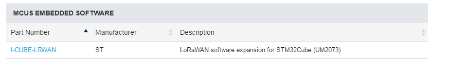

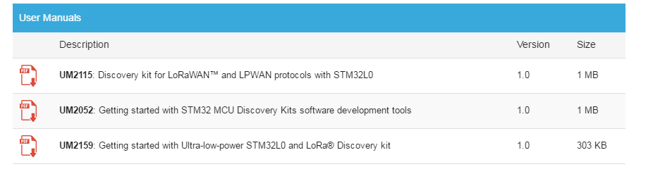

Hi
debuffel
,You have in the
/external-link.jspa?url=http%3A%2F%2Fwww.st.com%2Fcontent%2Fst_com%2Fen%2Fproducts%2Fevaluation-tools%2Fproduct-evaluation-tools%2Fmcu-eval-tools%2Fstm32-mcu-eval-tools%2Fstm32-mcu-discovery-kits%2Fb-l072z-lrwan1.html
page User manuals and a link to the software expansion for STM32Cube with UM2073 user manual.Hope this helps you.
Regards
Imen

2017-06-09 10:19 AM
Thanks Imen. I already downloaded these sw packages // however once downloaded there is not a document which explains how to use files (probably for the novice it goes without saying ... not for me (yet)). That's why I was looking for simple tutorial movie or doc.
