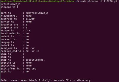

2023-10-15 10:09 PM
Thanks for sharing this..
Here, we also struggling to resolve the same issue..
But i have tried with ubuntu linux machine.
Could you please find the screenshot and let me know if any further process available to resolve this issue!!
Thank in advance.
