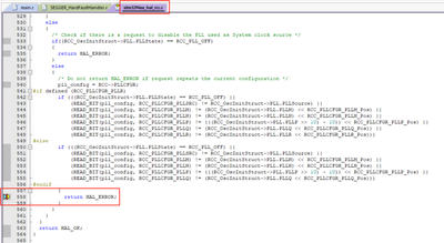

Now I try to debug the solution "BT2" to "APP1", and the jump is OK, but after some function call, the process is stopped at the hardfault_handler()...
2023-10-15 10:58 PM
finally, I traced to here:
(the error happened at function HAL_RCC_OscConfig() in stm32f4xx_hal_rcc.c )

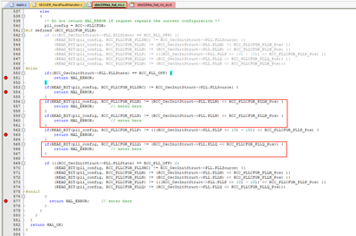

2023-10-16 2:34 AM
In following 3 "if" will return HAL_ERROR:
