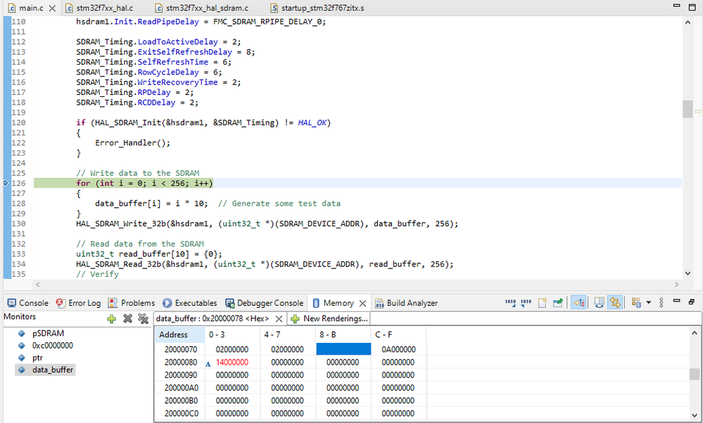

Right now I have debug the flash memory . using one integer type 32bit buffer variable. then store 256bit value but What happen here in stm32f767 memory .
My Quary how to understand the Debug section in stm32 or any type of controller
I give my snap anyone give the solution

You talk of FLASH but show code using SDRAM and dump internal SRAM in debugger.
Not sure why the dumped values are displayed in big endian format, not very helpful.
Having a hard time deciphering what the question is.

Actually what I have conveying ,first of all I has write the code for SDRAM write and read concept but im not using external SDRAM but this code is available in google I try to understand the code and debug..
but my doubt the code is stored on flash or internal SDRAM .
