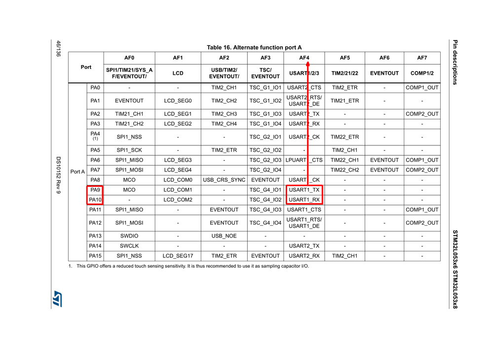

AF4 is set by software.
If you used PA9/PA10 for a UART connection in your design it will be usable as such.
For the System Loader see App Note AN2606 for supported PINS and METHODS.

Hello @BEKABEN ,
Correct, for UART instance 1 : PA9/PB6 -> UART1_TX and PA10/PB7 -> UART1_RX
For LPUART : PB10/PC4/PC10 -> LPUART1_TX and PC5/PC11 -> LPUART1_RX
Also, for UART instance 2 : PA2/PA14 -> UART2_TX and PA3/PA15 -> UART2_RX
Foued

is AF4 the default setting on the stm32l053r8?
2023-05-04 11:55 PM
No.
Default setting of all AF is AF0 - see GPIO_AFR registers description in the GPIO chapte of Reference Manual.

If I design my schematic based on AF4 and I'm accessing the UART from PA9 PA10 is it possible to do updates in the future?
2023-05-06 4:50 AM
