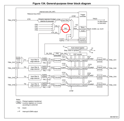

What is the purpose of the TRC bits? From the manual, I got that the bits do different things in different setups, but I couldn't find why this is necessary here or what TRC even stands for.

Sarra.S
I'm not exactly sure, but I would say TRC typically stands for trigger control.
Mapping to TRC is necessary when you want the timer to react to an internal trigger signal rather than a simple external input or clock signal, which is typically other timers within the microcontroller
