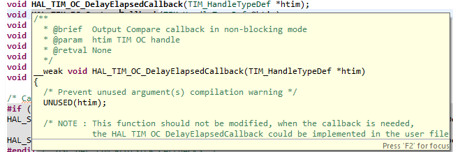

Here is a piece of code where I tried to implement the HAL_TIM_OC_DelayElapsedCallback() function which I think is the function I'm looking for.
I have a breakpoint in this function, but my program never returns in this function and I don't understand why.
"Output Compare callback" but i dont' understand why she's not working in my program ...

void HAL_TIM_OC_DelayElapsedCallback(TIM_HandleTypeDef* htim){
if(htim->Channel == HAL_TIM_ACTIVE_CHANNEL_2){
HAL_GPIO_WritePin(LD1_GPIO_Port, LD1_Pin, GPIO_PIN_SET);
2021-01-25 5:43 AM
