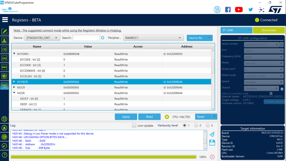

Hello @aerospace,
First, RAM ECC cannot be turned off. You can get started with this example. \STM32Cube\Repository\STM32Cube_FW_H7_V1.11.0\Projects\NUCLEO-H745ZI-Q\Examples\RAMECC\RAMECC_ErrorCount
For further details about event monitoring are described in RM0433 Section 3.4: RAMECC_MxSR register. This example can be ported to your STM32H7 MCU.

@F.Belaid thank you for your reply and the pointer to the example. As I understand it, there is no way to test detection by injecting known errors and need to rely on there being random single and double errors in uninitialised RAM.
