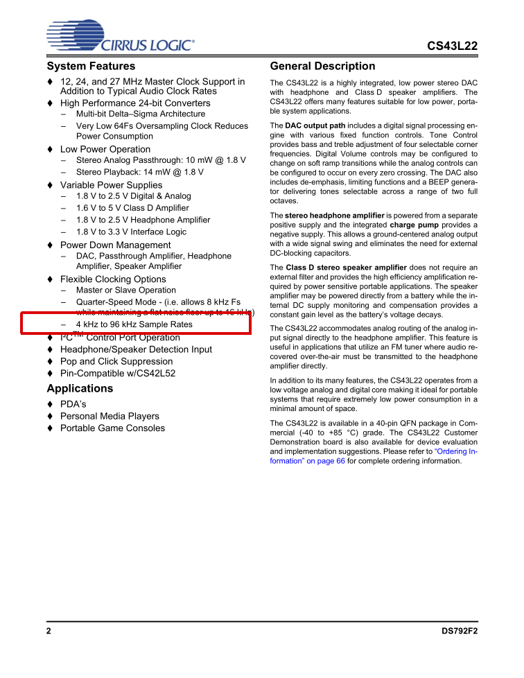

If you're talking about the on-board CS43L22 codec, according to its datasheet, it does not support 192kHz sampling rate.

It doesn't work well at lower rates, but 192k is in the datasheet and simple playback at 192k works a treat
You must then have a very different datasheet of CS43L22 than what I've just downloaded from Cirrus
