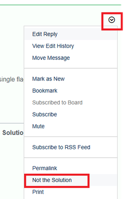

Sorry, I accepted it as the solution by mistake. I couldn’t find an option to unmark it. Could you please guide me if there’s a way to undo that?
2025-09-15 3:14 AM - edited 2025-09-15 3:15 AM
Meanwhile, using RAM still a solution for you.
2025-09-15 3:20 AM
@bhagat wrote:I couldn’t find an option to unmark it.
It is here. But it has been noted that this is not at all obvious:
Unmark Solution is too hard to find.
