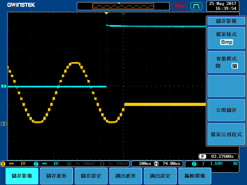

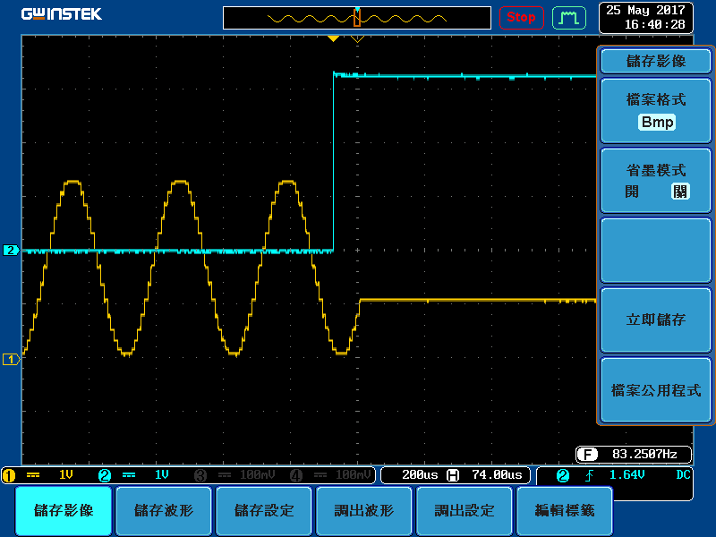

The dma setting is still in circular mode. Using TIM2's update event to trigger dac.
As to stop the dac only in the end of buffering,
I implemented aDAC_OFFRequest flag and a dac dma call backHAL_DAC_ConvCpltCallbackCh1.
Every time the 32 data are transferred , this callback is called. And IFthe turn off flag is set, the callback function will stop the dac.
I also use LD2(PA5) pin to trigger the oscilloscope. Toggle high as a DAC_OffRequest is set.
