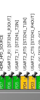

Check state of JP6
Make sure you have the GPIO D and USART2 clocks enabled, and that PD5 and PD6 is properly configured, with the right AF selection.

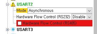

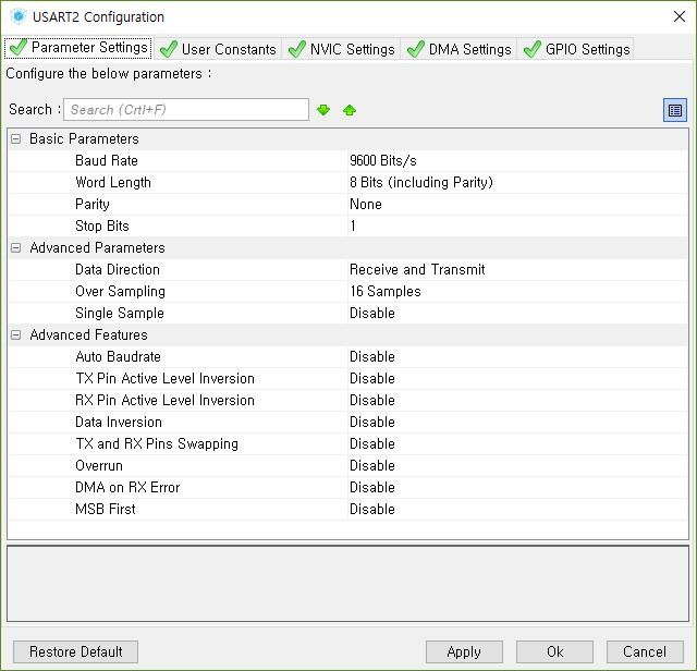

2018-08-09 2:02 AM
Yes, I already checked everything like below.
Do you have any recommendation to fix this problem?
