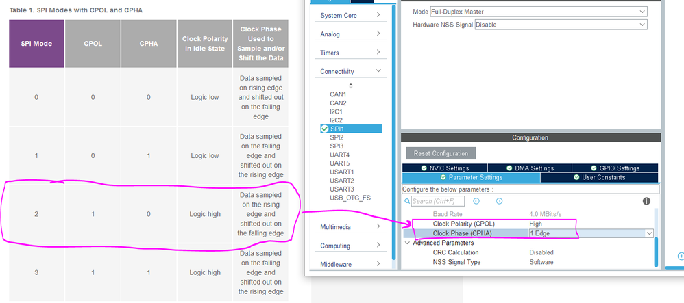

I'd like to setup SPI mode 2 in my project with cpol=1 and cpha=0. But in SPI setup for cpha options are 1 or 2 edges. Which option do I have to select?

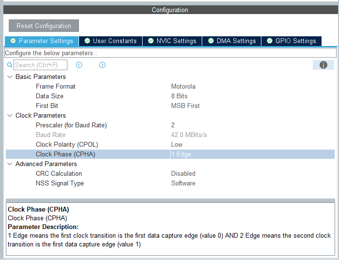

sample on 1st clock edge vs. on 2nd edge of clock.
Quite uncommon, but not wrong. And well explained in the IDE:
hth
