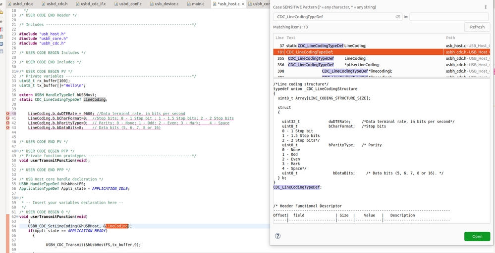

Perhaps review the source of the Arduino CDC, related to the line encoding
https://community.st.com/s/article/how-to-set-usb-cdc-line-coding
2023-02-20 6:00 AM
Thanks a lot Tesla DeLorean ;
did you have any idea how to solve this problem ? i'm trying to set the LineCoding values, but it gives me in turn "expected identifier or '(' before '.' token" & "expected '=', ',', ';', 'asm' or '__attribute__' before '.' token"!
