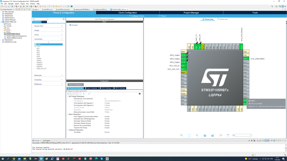

this is the settings image and the colck is ok 8mhz ext and working on 72mhz
