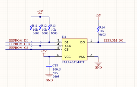

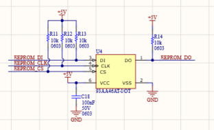

Here is the diagram:
The supply voltage is wrong and it is 3.3V.
I have also tried without pull-up resistor.
I do have an oscilloscope, and the DO trigger from low to high, when HAL_SPI_Receive or HAL_SPI_TransmitReceive are called.
2025-02-19 4:35 AM
Sorry, those images are too low resolution to read.
Are the EEPROM & STM32 on the same board? Is it a custom board? Or what?
SPI shouldn't need pullups - the lines should be actively driven both high & low.

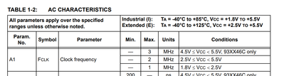

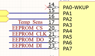

Start by checking your SPI CLK frequency according the the max clock mentioned in the memory datasheet:
+ You're using F1 family. Some IOs are not Five volt Tolerant (FT). As your memory is powered by 5V, are you sure your are not connecting EEPROM_DO output to one of the non-FT IOs?
2025-02-19 4:56 AM

2025-02-19 6:01 AM
Thanks for the legible images.
@Siva21 wrote:all pull-up resistors are removed, and eeprom is powered with 3.3V.
You could have corrected that before posting the image!

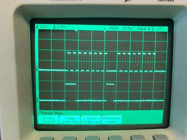

2025-02-19 6:04 AM
Thank you,
I have changed the MCU, didn't help.

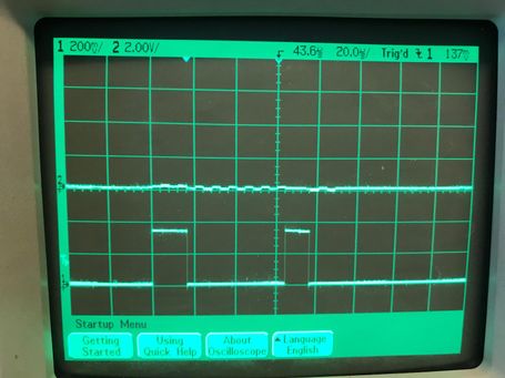

Here is results from oscillator when I use HAL_SPI_TransmitReceive to read from EEPROM.
The above signal is the clock, and below signal is DI, which it is 0b11000000 (from eeprom datasheet, to read from eeprom, has to be send 1100xx...).
Here is image from oscillator, which the above signal is DO (0V), and the below signal is DI, as before image, it sends 0b11000000.
