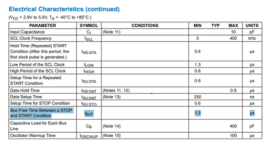

But if in the code below i put one delay of 1ms everything work perfect . So there is one "elegant" way to resolve the problem ? or there are other solution ?
It's possible that you're not meeting the tBUF requirements so the 1ms delay probably allows the slave to ACK?
1. Configure a timer to interrupt at a periodic time and in the timer callback, call DS2482_Status_Register.
2. In HAL_I2C_MasterRxCpltCallback you can check to see if the correct I2C peripheral caused the interrupt and set a flag.
3. In main while loop you can check for the flag and then test data for 0x02. From there you can continue to what you need to do.

2026-01-27 2:25 PM
