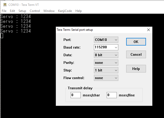

2020-10-28 7:21 AM
here my test, it works on my side with trace using TeraTerm.
main.c
#include <stdio.h>
/* USER CODE END Includes *//* USER CODE BEGIN PV */
char str[16] = {0};
uint32_t servopot = 1234;
/* USER CODE END PV */int main(void)
/* USER CODE BEGIN 1 */
/* USER CODE END 1 */
HAL_Init();
/* USER CODE BEGIN Init */
/* USER CODE END Init */
SystemClock_Config();
/* USER CODE BEGIN SysInit */
/* USER CODE END SysInit */
MX_GPIO_Init();
MX_USART2_UART_Init();
/* USER CODE BEGIN 2 */
int size_len = sprintf (str, "Servo : %lu\n", servopot);
/* USER CODE END 2 */
/* Infinite loop */
/* USER CODE BEGIN WHILE */
while (1)
HAL_UART_Transmit (&huart2, (uint8_t *)str, size_len, HAL_MAX_DELAY);
HAL_Delay(1000);
/* USER CODE END WHILE */
/* USER CODE BEGIN 3 */
/* USER CODE END 3 */
}Can you shareyour code (UART2 setup) and hardware you use ?
