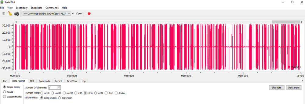

I tried to read out MIC( Infineon-IM69D120) data with NUCLEO-H743ZI2 SAI PDM interface as below but no lucky, the expected audio freq is 16KHz, attached are the src code and pcm data log in a quiet environment, could you help to check why the data was not close to zero?

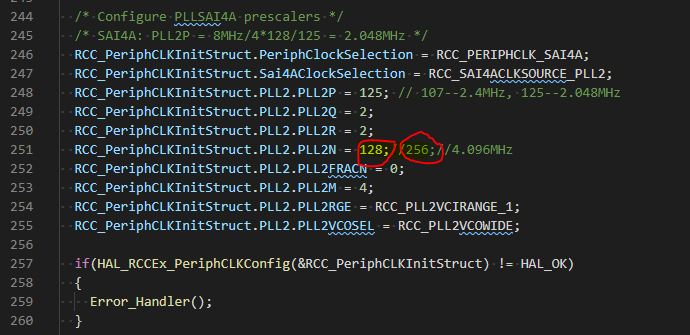

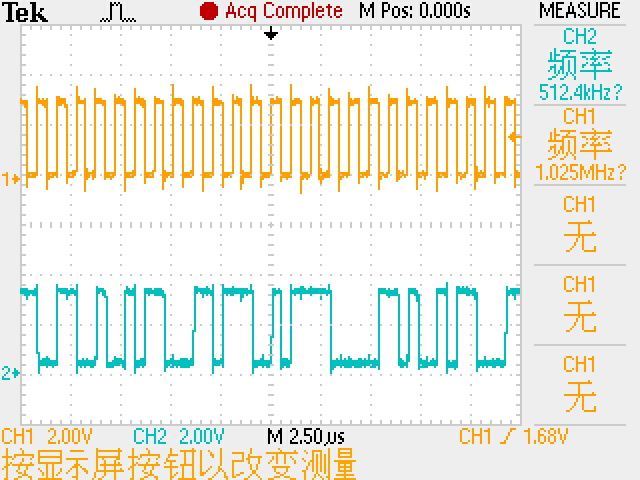

Two more questions:
1, The PDM clock seems could not be modified to 2.048MHz? No matter what the PLL2.PLL2N was, whether it was 128 or 256, the PDM clock always was 1.024MHz.
