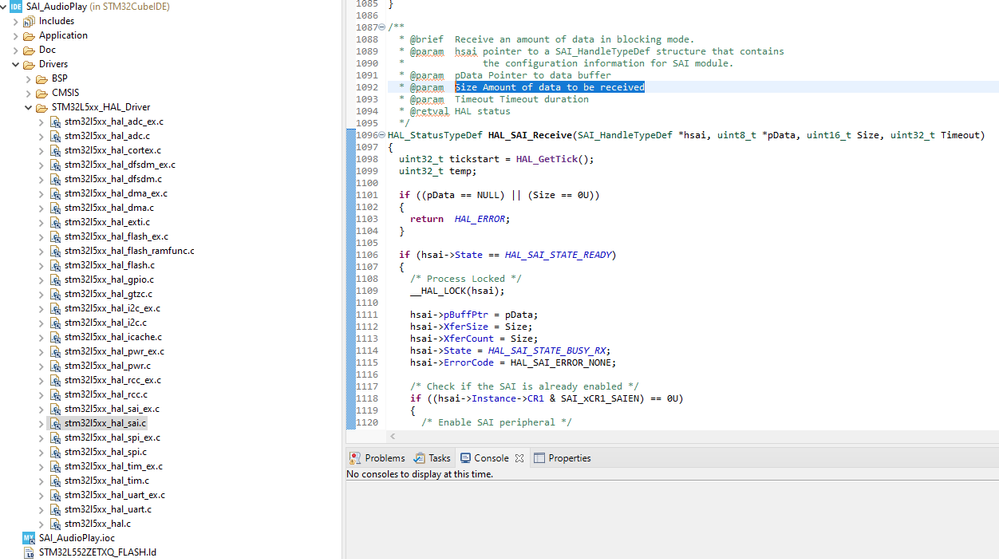

2023-01-03 3:44 AM
I have this example in my IDE environment
And I can see the function :
HAL_StatusTypeDef HAL_SAI_Receive(SAI_HandleTypeDef *hsai, uint8_t *pData, uint16_t Size, uint32_t Timeout)
In this example SAI_AudioPlay it's not the same thing i'm looking for. First I don't have the same CODEC and I just need to acquire the data via an input from the CODEC that's all.
