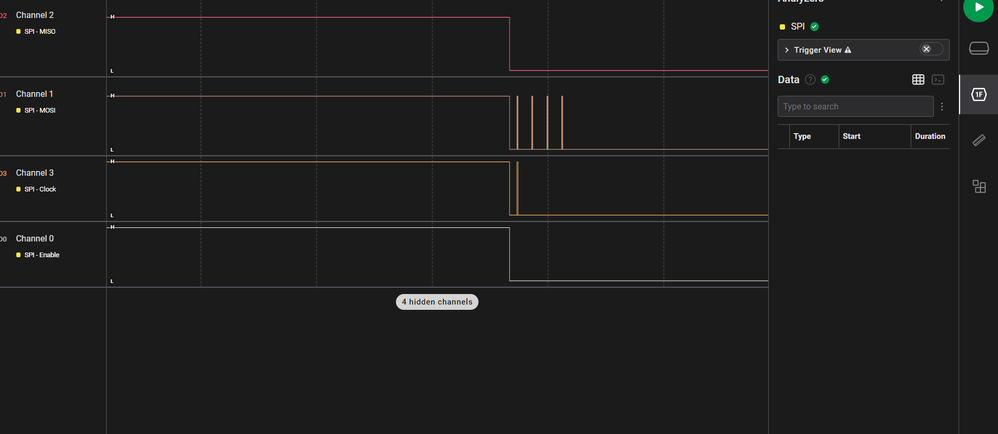

2023-06-06 9:44 PM - edited 2023-11-20 3:51 AM
Yes, the number of clock pulses matches the number of data bits transferred , but sometimes not all the times .
slave is working in SPI 4 wire. My slave is the MAX30001 sensor, and this sensor is connected to the STM32 with the level shifter and buck converter because this sensor requires 1.8 volts.
figure , which is mentioned below has some change D3 line is basically MOSI and D1 line is CLK
