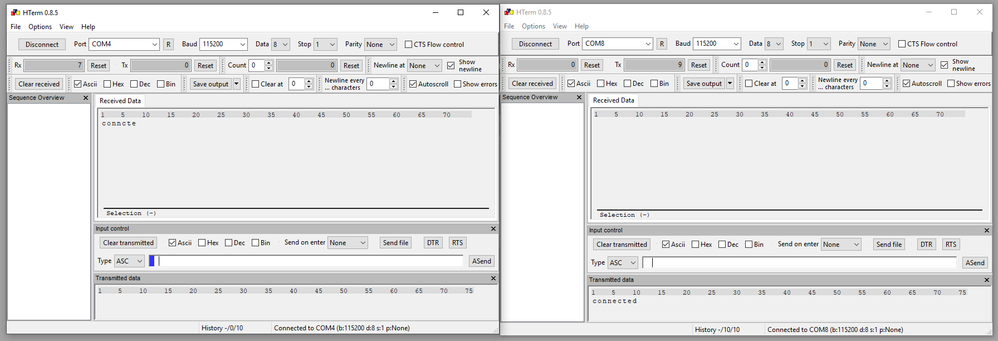

This is an example of what happens when I transmit a message. COM 8 is mu USB to TTL and COM 4 is my STM32L073RZ board. As you can see, it skips the 5th character and the 10th.
