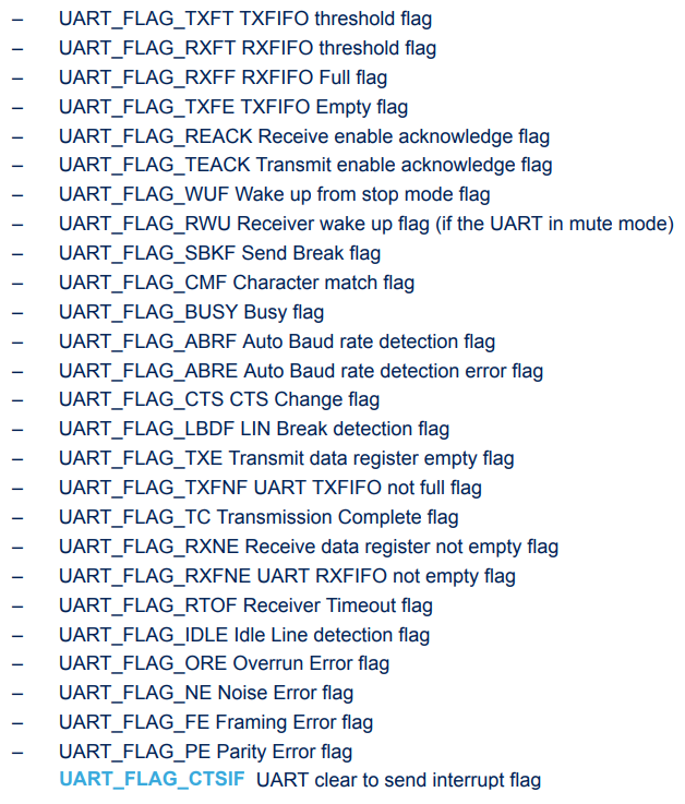

Ok, thanks! So, I set a counter in the HAL_UART_IRQHandler to see how many times it's triggered for one UART transmission. And, regardless of the length of the string, the function is called 4 times: 2 times before any UART transmission and 2 times after. Looking up close, the HAL_UART_IRQHandler is firstly called with the IDLEFLAG set, but then without.
Knowing the possible IT flags are the next ones:
I tested all the flags when the HAL_UART_IRQHandler was called, using __HAL_UART_GET_FLAG(). Only the UART_FLAG_IDLE is toggled.
Does that means the HAL_UART_IRQHandler is called either when the UART_FLAG_IDLE is being set or reset, even if I reset it in the HAL_UART_IRQHandler?
