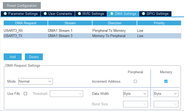

2022-05-10 7:35 AM
I suggest to use USART with DMA and idle line detection.
below is an example
uint8_t RxBuffer[256],RxLenght;
// in init
HAL_UART_Receive_DMA(&huart3,RxBuffer,255);
__HAL_UART_ENABLE_IT(&huart3, UART_IT_IDLE);

2022-05-10 7:50 AM
Hi @Muhammed G�ler !
Thanks for the screenshot and code, seems pretty simply and efficient. I'll give it a try and let you know about it.
Loïc

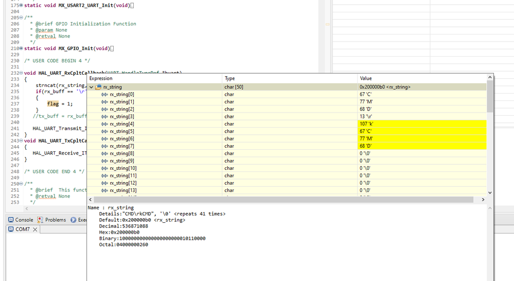

2022-05-11 12:31 AM
Hi again!
I'm trying to detect the '\r' character at the end of the sent string, but when sending a string via the STM32CubeIDE built-in serial monitor in debugging mode, I get a strange behavior. See in the screenshot below, sometimes there is the '\r' at the end of the string (when I first sent "CMD" and hit Enter), sometimes not (then I sent "kCMD").
How could I manage to get the '\r' every time when I send a string?
Loïc
