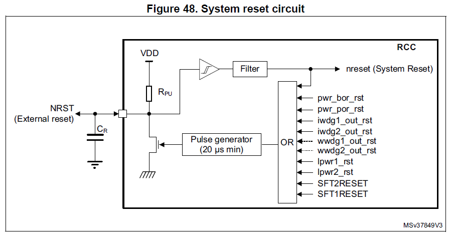

For example: M7 program opens the watchdog, when the program enters hardfault, only M7 program is reset without affecting the normal operation of M4.
2020-11-06 9:15 PM
A reset from any source pulls NRST low and does a full system reset. There's no way to use the watchdog to reset only the M7 core.
