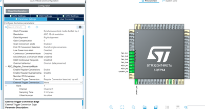

I just want to read 2 channels of an ADC but am presented with a bewildering array of incredibly confusing options: Ranks, Continuous mode, discontinous mode, number of conversions, oversampling, triggers, etc, etc, etc. The embedded "help" is completely useless.
I have two SE channels of ADC1 enabled (1 and 2), and I want to sample them both NOT in DMA. Seems reaonsonable but after hours of trying I can find nothing that works, and no resources to help. I'm trying the code below and various offshoots of it.

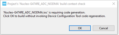

If you need to build the project, ask OK to build without invoking Device Configuration Tool code generation by CubeMX.
The reason is because the initial Mx configuration has been overwritten in the code.
