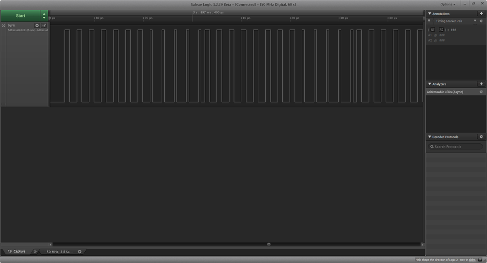

Okay I got an update for you. Yes that 32bit, I fixed it realized CCR1 is a 16 bit register it did fixed some weird PW I was seeing on the line.
PFCTRL is not set, it puts a 0 to make it a DMA flow controller, I see why you thought that. I could remove it.
TIM15 for whatever reason has 2 DMA request TIM15_CH1_DMA, and TIM15_CH1_UP. I tried the latter but didn't work so I had to use the former.
Picture of the Updated Changes, still not perfect.
The array for reference:
uint16_t GREEN [25] = {0xEF, 0xEF, 0xEF, 0xEF, 0xEF, 0xEF, 0xEF, 0xEF,
0x77, 0x77, 0x77, 0x77, 0x77, 0x77, 0x77 ,0x77,
0x77, 0x77, 0x77, 0x77, 0x77, 0x77, 0x77 ,0x77, 0x00};Like its outputting 9 0xEF? then the rest looks good, and I don't know about that last one
2021-01-10 6:19 PM
Actually I got it working, I dont know why this fixed this but maybe you can help me explain this but removing "TIM15->CCR1 = RGB_Array[0]" made that extra 0xEF go away. Now everything is working, the 32bit to 16bit fixed the weird data and removing that line fixed the timing. Still dont now why the TIM_CH1_UP didnt work as well
EDIT:
I think I have an explanation as to why it worked once the TIM->15 code was removed. When I set TIM15->CCR1 = RGB_Array[0] I force the TIMER to output a value before the DMA can transfer, I believe once it outputted that it request the DMA to shove another value into it, so it was 0xEF (DMA REQUEST) and that being another 0xEF and so on. So I was just amending the buffer essentially.
