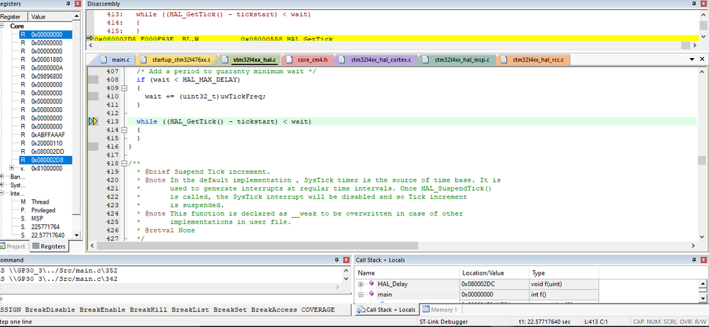

I am trying to communicate with a peripheral device through SPI interface using the HAL SPI library functions. But the function is not working properly. It is getting stuck inside the HAL_Delay function. HAL_SPI_Transmit function just executes an empty infinite loop. I am attaching the screenshot of the debug window pointing to where I am getting stuck.

If doing this in a callback be aware that this is under interrupt context and SysTick will need to be able to preempt, and that HAL_SPI_Transmit is a blocking function best not used in an interrupt/callback.

Actually the main problem that I am facing is that when I use the HAL_SPI_Transmit() function in small programs that have size less that 2kB, the function works perfectly. But when I include the same function inside the programs with size greater than 20kB, it gives the above mentioned error.
