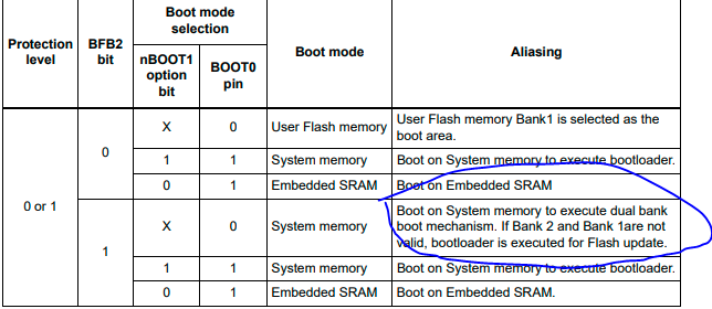

Jumping to the bootloader is not the issue now.its jumping to bootloader from user app and as it sees the valid code in user bank1/2 its jumping back to the user app.
Referring to AN2606(system memory boot mode)
below is the only case where bootloader will go to flash update
i need to achieve above conditions so that it will go to dfu. i tried to erase the bank 1 and 2 but no luck. need some more information on it.how can i erase the both banks before jumping to bootloader from user app?
PLease correct if my understanding is wrong.working first time on STM device

Setting flash to 0 is not the same as erasing it. The erased value would be 0xFFFFFFFF.
