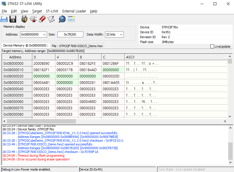

When I use the ST Demo hex file to program to my custom board by ST link Utility, it shows message: ''time out during flash program''.
Here is image:
Could you please help me to solve this ?

It looks like no way to change ST-LINK pin configuration to QSPI Flash.
I suggest use external programmer to program your code.

2018-03-13 7:03 AM
You would need to craft a custom external loader to address the specifics of your board and part choices.
