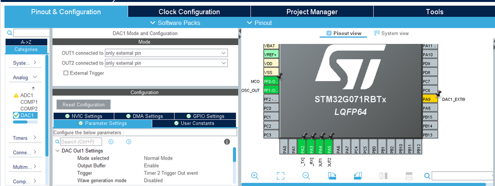

Btw, i encountered this problem. I saw your comment in other post for dual dac mode.
If i choose two dac channels and the trigger source for both of them is tim2. Do i need to choose this external trigger too? How do I call them in the main code?

I did this to trigger DAC but this is not working. Could you help me with this?
2023-03-14 10:02 AM
You don't need to use any trigger - leave DAC_CR.TENx = 0, and then what you write into DAC_DHRx is automatically transferred to the output register and after the analog settling time appears as voltage at the output.
I don't use Cube/CubeMX and don't know what are the incantations to achieve the above. DAC is very simple, it can be easily used directly through registers, and the DAC chapter in RM contains an exact description of its functionality.
