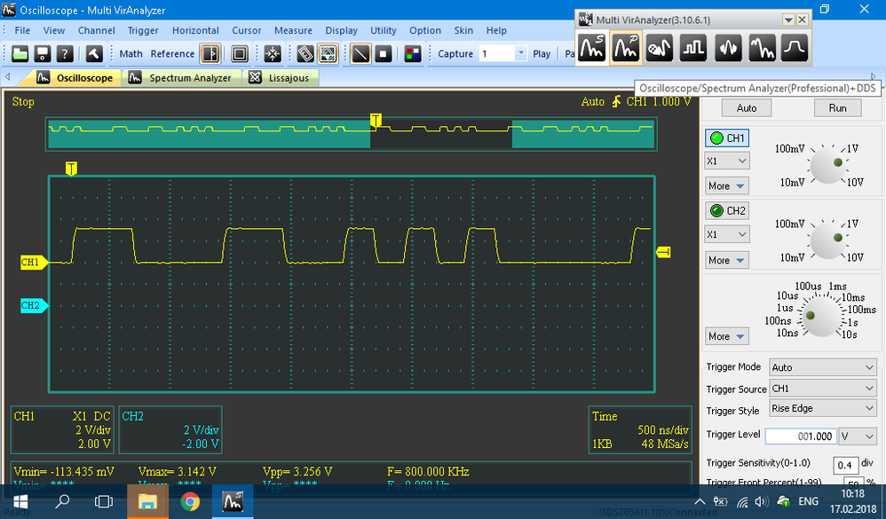

Yes, it is not simple at all. I perform some test:
MOVW R0, #(1 << 12)
LDR R1, =GPIOB_BRR LDR R2, =GPIOB_BSRRBlink_Loop
STRH R0, [R2
] STRHR0
, [R1
] STRHR0
, [R2
] STRHR0
, [R1
] STRHR0
, [R2
] STRHR0
, [R1
] STRHR0
, [R2
] STRHR0
, [R1
] STRHR0
, [R2
] STRHR0
, [R1
] B Blink_LoopOther conditions are the same: no interrupts, dma, prescalers etc. Freq is 16MHz HSE (clock every 0,0625us). And I get this picture in my oscill:
Pulse [0,5 us], Pause [0,75 us], Pulse [0,5 us], Pause [0,5 us], Pulse/Pause [0,25 us] Branch pause [> 1us]
So, the fastest command takes 4 system ticks, branch takes 16 O_o
I really really really don't get it... maybe I'm just to old to figure out brand new things in this SoCs.
But what I actualy figured out, is that the SoC can not complete the task I wanted to... Very sad
