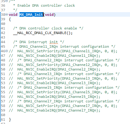

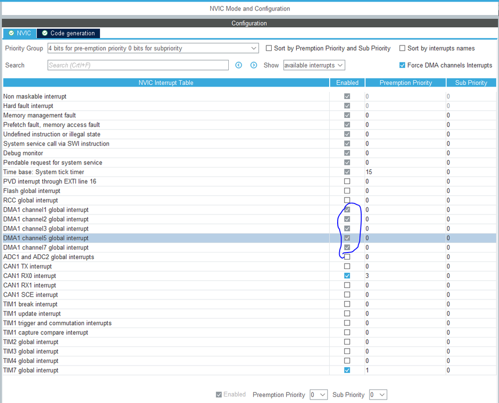

2022-05-04 5:12 AM
@Piranha CubeMX for some reason autogenerates ISR functions when DMA is activated
They prevent you from "unticking" the NVIC enable option.
I dont need them and i dont want them..
@Community member I placed some breakpoints in the ISR callbacks and they are never reached.... (probably because im using HAL_DMA_Start() instead of HAL_DMA_Start_IT() )
I just removed all ISR init code and callbacks ,the DMA still works as intended,The interruptions were not being triggered nor used.The original problem is still there but now i know , the issue is not in the ISR functions.
