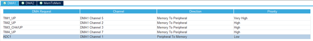

Im using a stm32f105RBT6 and i am in need a ton of softpwm pins.
My solution (with the help of @Community member ) was to run 4 DMA channels triggered by 4 different timers addressing 4 different GPIO ports (in a circular mode).
This worked like a charm untill now.

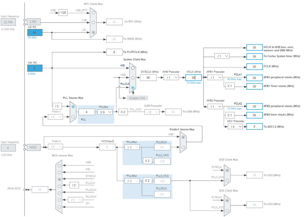

Now i cannot use the external XTAL anymore, limiting the main clock down from 72Mhz to 36Mhz, this makes the softPWM of the DMA channel with the least priority to lack behind in frecuency.......

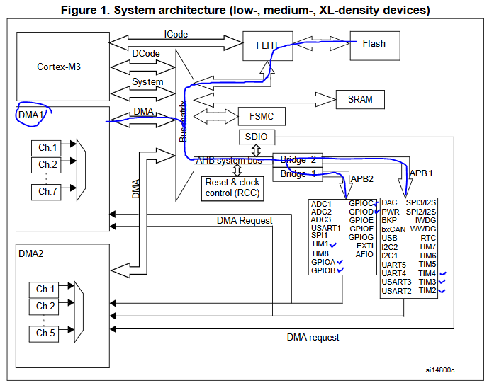

I dont know a lot yet about APB /AHB buses but :
The DMA1 should be completelly clogging the buses

> How to know if the buses/DMA are already at its limit.
Decrease the timers period -> DMA rate.
But a few kHz DMA at 36MHz system clock should not be an issue. And it should not depend on optimization level, not the least. This is something else.
Are these 4 timer-triggered circular DMAs transferring from memory to GPIO, and nothing else?
EDIT Oh, it's an 'F1... GPIO is behind an APB... that might be a bottleneck, and if software accesses peripherals on the same APB, it could be software-dependent indeed... and then even the "inverse" dependence makes sense - the better the software, the more APB is loaded and prevents DMA from working properly... so find what is loading the given APB bus in software (e.g. tight polling loops) and try to relieve on them.

Thought the F1 could do 64 MHz from PLL+HSI

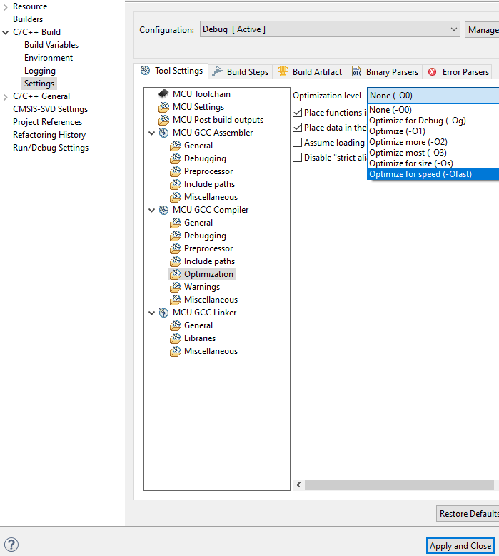

Get rid of the HAL bloatware, polish the ISR code thoroughly, set optimization to Ofast+LTO and you will have ISRs running much faster.
2022-05-02 11:59 PM
I cannot get rid of the entire HAL because i need to meet a realistic deadline, i but i could polish the ISR, lets see how it goes.
I never changed the optimization options, ill have a look
It was an unpleasant susprise for me too (question in st community)
No luck changing the PLL parameters manually, it seems to be at its limit at 36Mhz.

2022-05-03 1:00 AM
Optimicing for Ofast worsens the situation somehow.... softpwm with least priority goes even slower

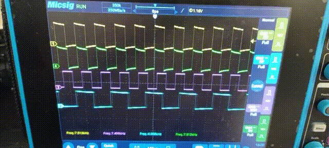

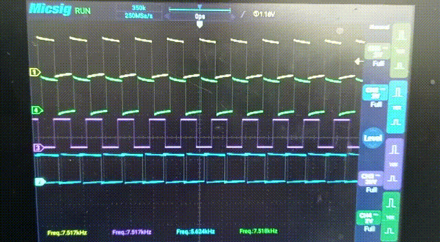

In order:
they were all supposed to be 7,5Khz 50% softpwms
Without optimization i get a lazy 5,6Khz 50% in the GPIODWith optimization i get an even lazier 3~4Khz 50% in the GPIOD
