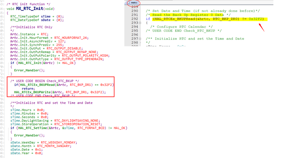

2024-08-06 10:56 PM
Check the RTC init code of your HAL/LL. I remember that I had to add a check if the RTC is already initialized and running, because the default code always did a re-init the RTC on startup.

Thanks for all the replies.
In the end, this function was completed through the help of an agent. I posted it for reference if I encounter it later.
