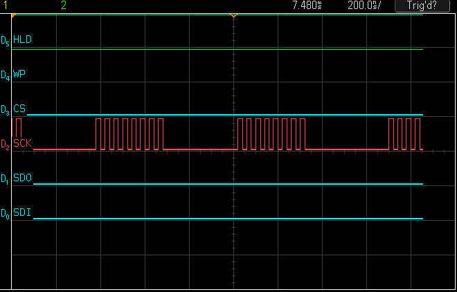

I'm using this code to read from a flash chip with quad SPI:

}The clock is 25 MHz and looks like it works, the received data is what I wrote to it, but there are gaps when reading:
I already tried to enable D-cache and I-cache, and compiled it in release mode, but no changes. The destination RAM is RAM_D1. I also tried different "Fifo Threshold" settings in CubeMX, but no changes. How can I speed it up?
I saw in the HAL code that OSPI_WaitFlagStateUntilTimeout is called for each byte, and the function doesn't look nice. Maybe someone has already implemented faster code, or would there be always a gap and I need something different, like DMA transfer?
2021-04-02 12:45 PM
I found the problem. I forgot to click the "MDMA global interrupt" checkbox in CubeMX.
