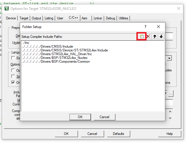

Or you can add the path of the folder that contains the two subfolders to you project, for example in keil go to :
option for target -> C/C++ -> Include Paths:
in the screen below
Click on the button in the red rectangle then add your path.
Mohamed Aymen.
