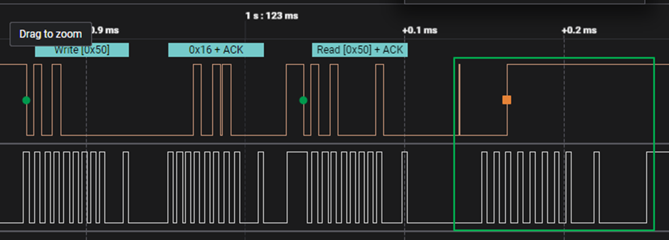

Hi, I want to make I2C By GPIO I/O Ports Using STM32F103RBT6 64 Pins.
run my source code result is above figure.
When I2C Input Read time, It Can’t read data how can I get input data?

@Simon_Sung wrote:It Can’t read data
What, exactly, does that mean?
What debugging have you done to find out what's going on?
If you step through the code, does it correctly identify the input level?
@Simon_Sung wrote:
Remember that I2C requires open-drain drivers...

Hello
Is your SDA_Pin defined as GPIO_PIN_11 ?
