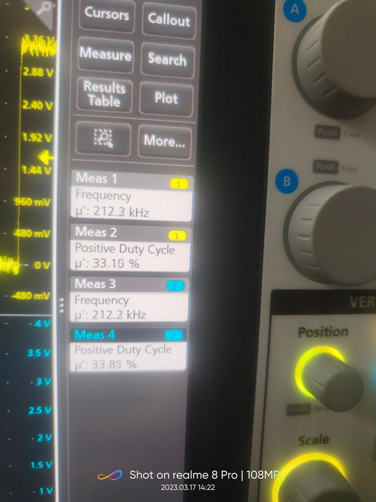

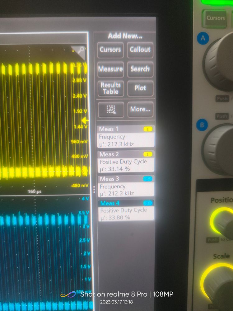

i want to generate 50 % duty cycle at freuency (100khz-200 KHz), but i am not getting 50% , i am getting 33-34% duty cycle.this duty cycle change when the frequency change.

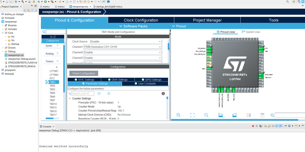

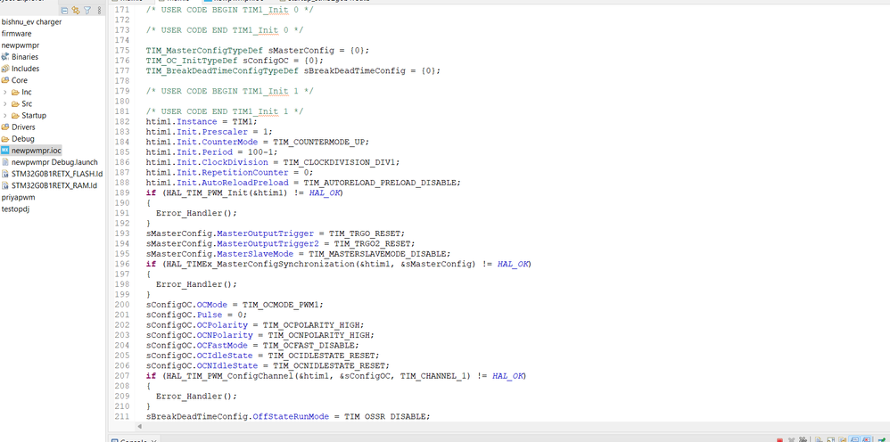

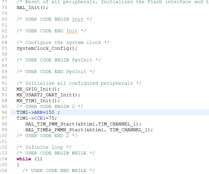

Show the functions initializing the timer.
Is the frequency as expected?
ARR = N - 1
CCR1 = N / 2

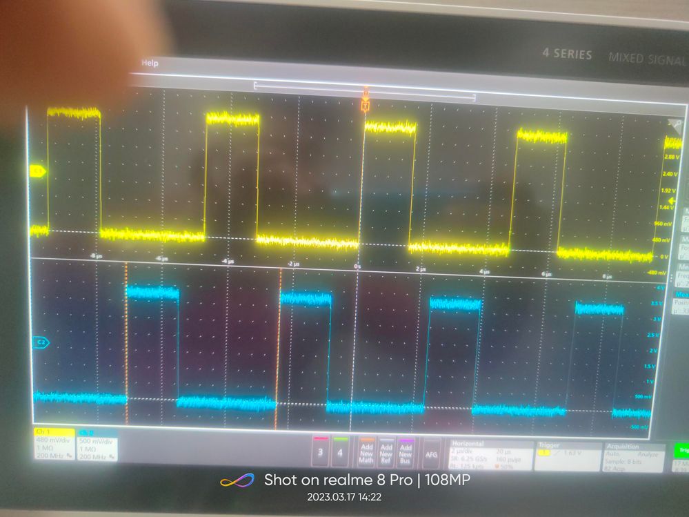

From the scope screen it's hard to see the cycles, or if they are complementary.
Show all registers in TIM1

YES ,Frequency is same as expected

2023-03-17 1:51 AM
ARR = N - 1
CCR1 = N / 2
for this parameter
ARR = 150-1
CCR1 = 150/ 2
2023-03-17 1:54 AM
2023-03-17 1:59 AM

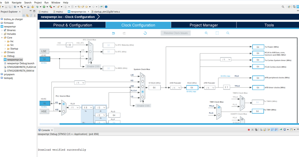

i am using the stm32 g0b1re Microcontroller Board

time clock -64Mhz
prescale-64-1.
so i will get frequency 64/64= 1 Mhz.

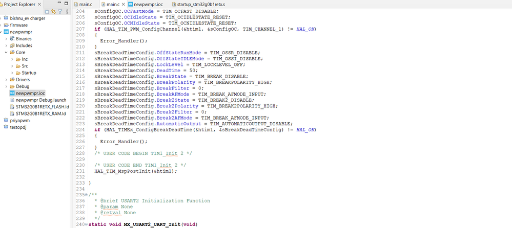

not wrong, but maybe there is some deadtime active.
timer -> complementary outputs = usually need deadtime .
try setting it very short.
+ set timerclk 64M , no prescaler.
for 10khz out -> arr 6400 , 300khz out -> 210 .
