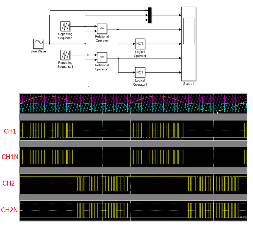

What is three level PWM? Can you post sketch of the expected waveform?
2020-05-23 2:44 AM
this is the concept block diagram and the required pwm waveforms

How does this differ from any other cycle-by-cycle-controlled PWM?
You probably want to review the timer-DMA examples in Cube, where from a prepared table, related reghisters (CCRx) in timer are changed by DMA triggered from Update of the same timer, through the TIMx_DCR/TIMx_DMAR mechanism.

The difference is I have to compare the sinewave to two sawtooth signals, not one like the traditional pwm
2020-05-23 4:29 AM
Well, that just means using two channels, as you've remarked above. The difference in the table-DMA-driven approach is then, that DMA does not feed one channel but two, that's why using the DCR/DMAR mechanism.

The A-F timing units in HRTIM each have its individual DMA trigger/channel so they can simply work out of two tables determining their individual output waveforms.
For the "idle" state, I'd try to use the fact that
A compare value greater than the period register value will not generate a compare match event.
in which case only the set/reset assigned to Period would be active.
