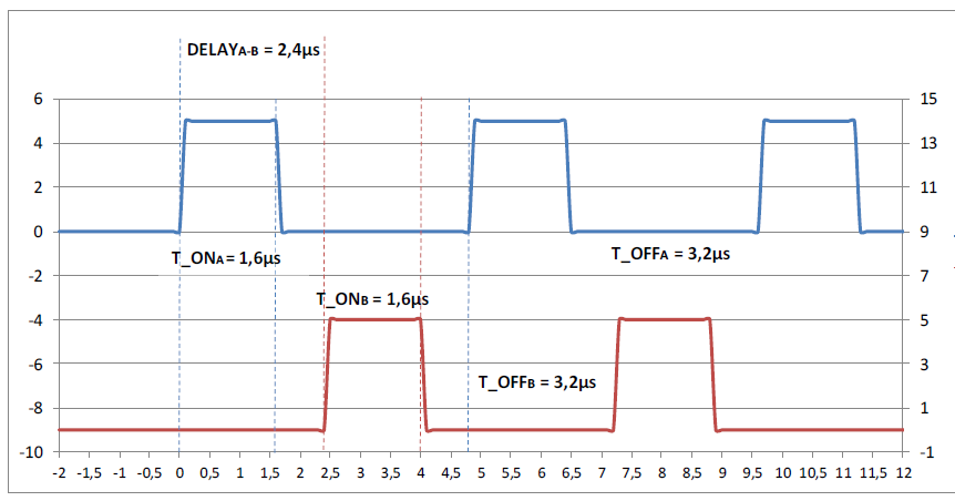

I have the stm32F429 micro and I need to generate 2 PWM Output (see below) using pin PB0 and PB1. I tried with toggle mode and TM3 on ch3 and 4, but the duty is 50/50 and is not good. There is a phase shift of 2,4us. Do you have any suggestions?2016-01-21 7:39 AM
There is only one counting element in a timer, so you can't produce this using a single timer.
You can chain TIM1 and TIM3, running with the same period (they are on different APB buses so you might need to think about the particular ARR setting for both), triggering one (with the phase difference set in CNT) from the other. Don't forget to set TIM1_BDTR.MOE for TIM1 and don't forget that it's the inverted outputs of TIM1 on PB0/PB1, so you might compensate for this by different timing or setting the other PWM mode or negating by CCER.CCxNP. Do this step by step - first achieve the two PWMs on two timers, then learn how to chain them/trigger. JW2016-01-21 10:38 AM
