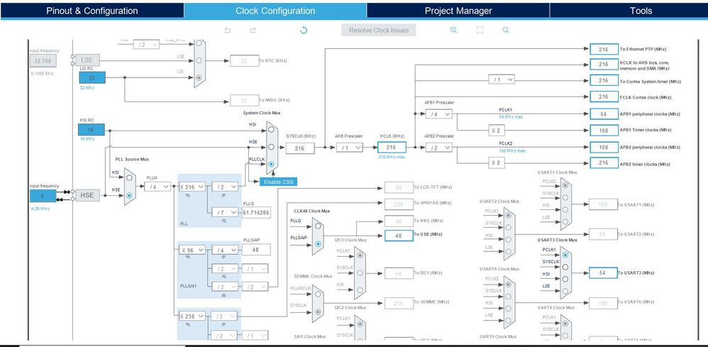

0693W000006H8xOQAS.jpgPlease find attached an image of the clock configurations that were created in STM32Cub3MX.
I am using TIM3 which is associated with APB1, so the MAX frequency for this would be 108.
Please find below the configuration of the TIM3.

With the above setting of Prescalar & Period, The least interrupt trigger interval I get is 1.6us, But I need exactly 1 us.
