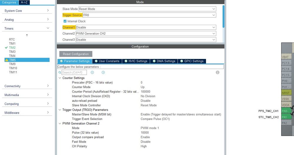

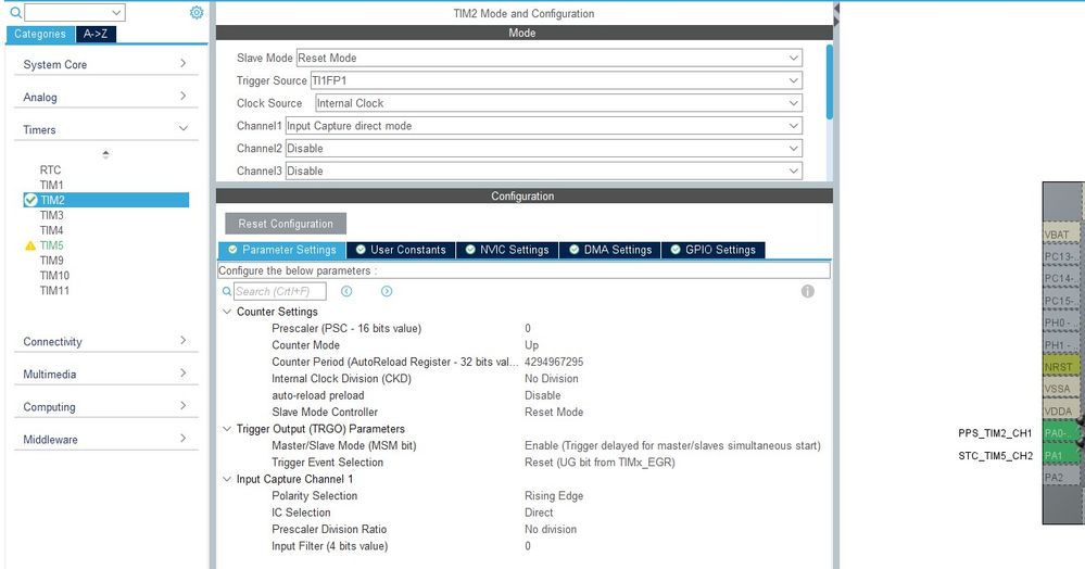

I tried to use slave with gated mode but did not able to generate falling edge event/interrupt of input (PPS from GPS) at TIM2-CH1 (PA0, 32 bits timer). So finally, I have gone with Input Capture direct mode with slave Reset, trigger source with TI1FP1 as attached picture.
ADC start pulse is PWM out in mode 1 from TIM5-CH2 (being nearby pin, PA1), slave with Reset Mode, Trigger source ITR0. I able to get results as expected, sync with gps's pps pulse rising edge, measurement of pps width in 32 bits accuracy with 100 MHz, adjustment of adc sampling rate based on measurement of pps pulse, pulse free running as well when PPS is not available due to some weather or failures. Being used two timers, it give more flexiblity to control the prescaler without effecting each other. The Gated mode must be much simpler than this, but do to configuration issue of event/isr for falling edge, I ignored it. I do not want to use more IOs also.
